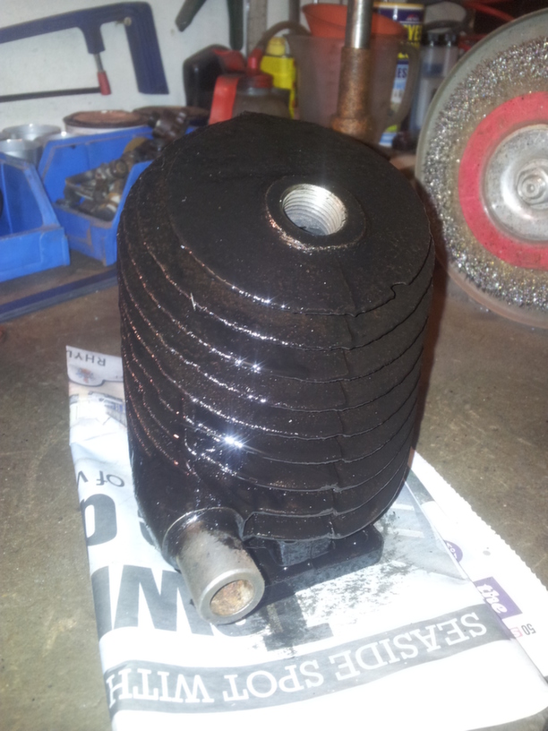

December 20, 2013 at 10:24 pm #4275
darmic1ParticipantDecember 20, 2013 at 10:30 pm #4279
darmic1ParticipantDecember 20, 2013 at 10:32 pm #4282
darmic1ParticipantDecember 20, 2013 at 10:38 pm #4285
darmic1ParticipantDecember 21, 2013 at 4:56 am #4288
