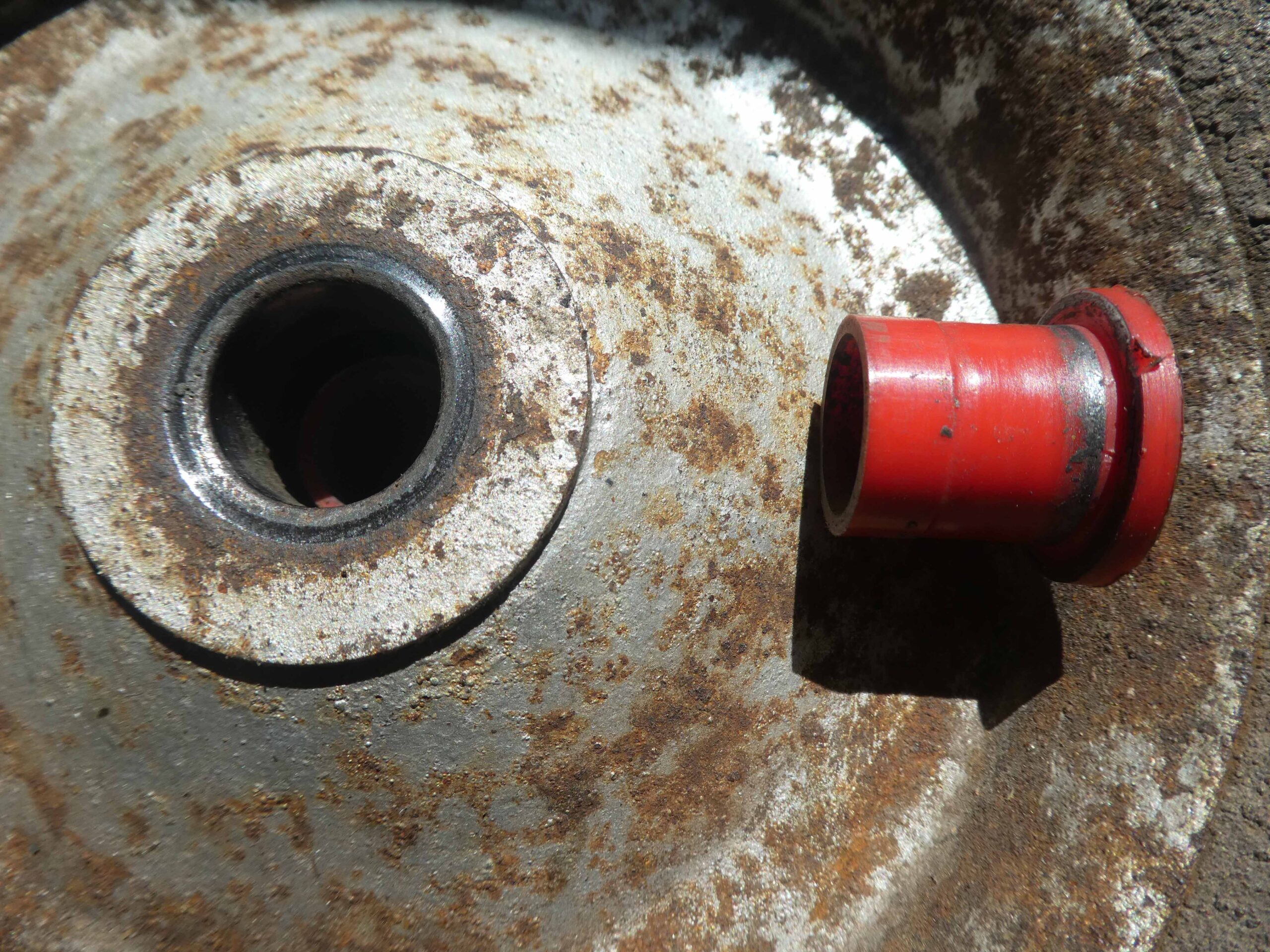

    Does anyone know where I might be able to get replacement plastic wheel bushes, similar to the one pictured, for a 1960s Hayter rotary mower?
    Or is there an alternative I could use or adapt?

    I use Delrin plastic and turn my own bearings out of that stuff.
    Delrin (polyoxymethylene or POM-H) is a high-performance engineering thermoplastic famous for bridging the gap between plastics and metals. It offers exceptional mechanical strength, stiffness, dimensional stability, and low friction, making it a premier choice for precision mechanical components, gears, and bearings.
