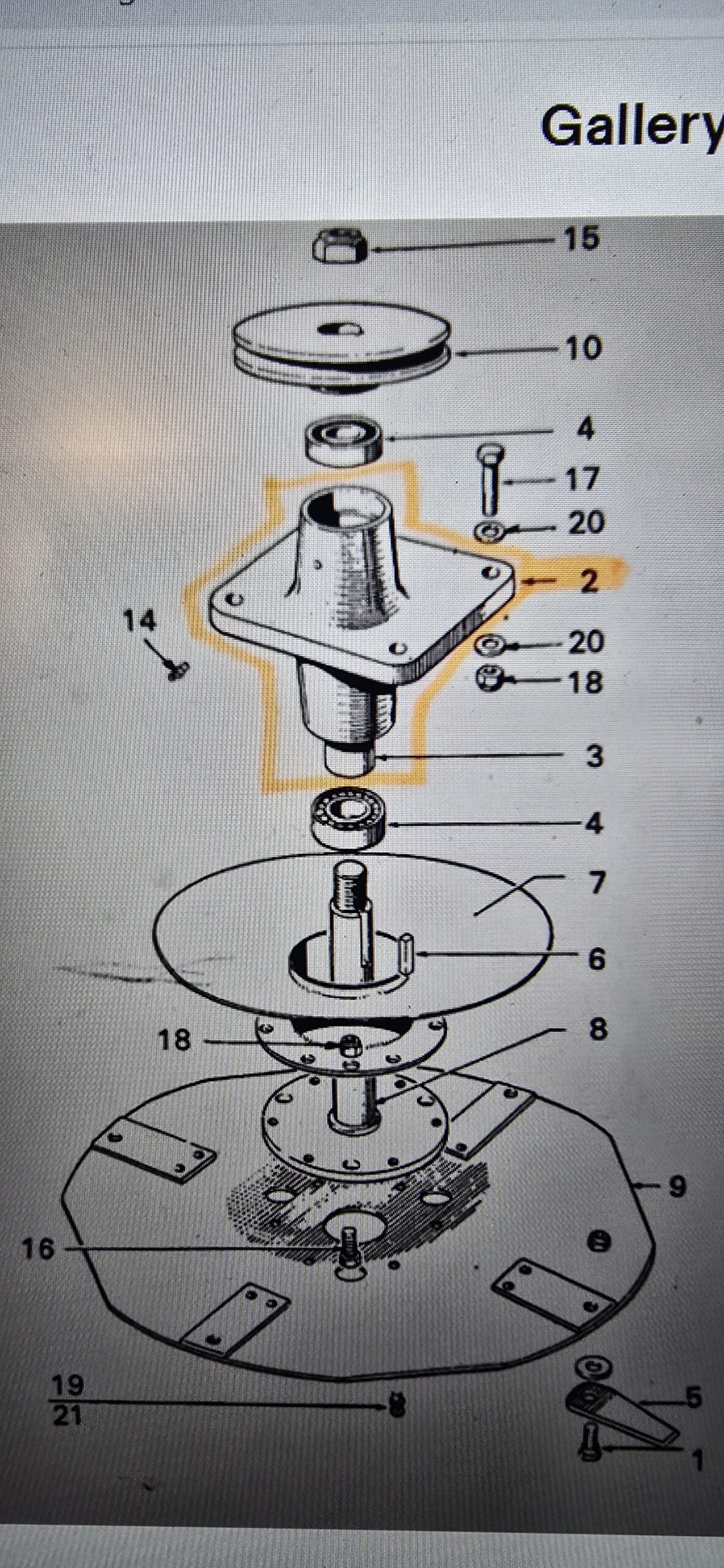

I need two cuttershaft bearings for my 1989 Hayter 21 rough cut mower.
They are listed as Part number Hayter 2384 but are long obsolete.
They are of the ball bearing type.
Does anyone know where i can get replacements from please.
there was a bearing part number on the bearing but it has rubbed away.
Part 4 in the diagram
Thankyou in advance

ParticipantI have run two Bolens mowers now 43 years, and rebuilt the decks a few times, I went to replace the bearings and found they are a odd size, one firm said couldn’t I get the housings turned out to take a standard bearing, well they are not that strong to start with, so I tried Hayley’s Norwich, they have other branches. they said we keep them specially for you old boys. However I could have machined down a standard bearing and then ground to the finished size. as have done several for replacement obsolete bearings for early cars. The Bolens bearing sizes are, bore 3/4” OD 1.780 width .608. photos of Bolens, 1905 Rover gearbox bearings being turned down to size.

sidevalve5ParticipantAnother way of getting bearings that I have done many times is to get one from one of the large online suppliers. I have used Bearing Boys and Simply Bearings. If the bearing has a manufacturer and a reference number on it. You can cross reference it with the company’s lists. If not, measure the OD, ID and width and put that in the company search engine. You will need to determine if the bearing is metric or imperial first though. A 1989 machine may have either size as it was in the middle of a period when the sizes changed. The balance of probailities is that Hayter used a stock bearing that is still readily available. But would firstly take advantage of David’s kind offer, he has vast experience in these matters.
