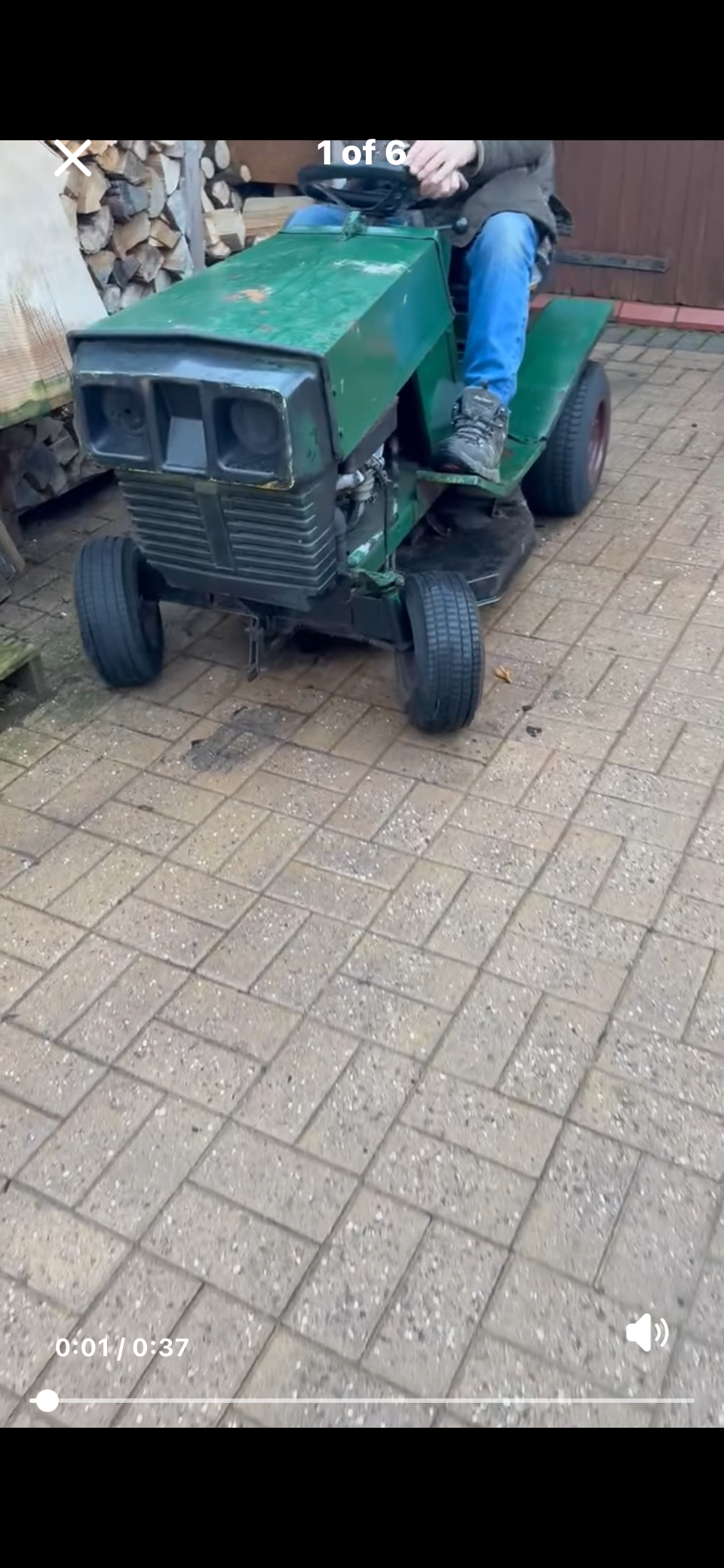

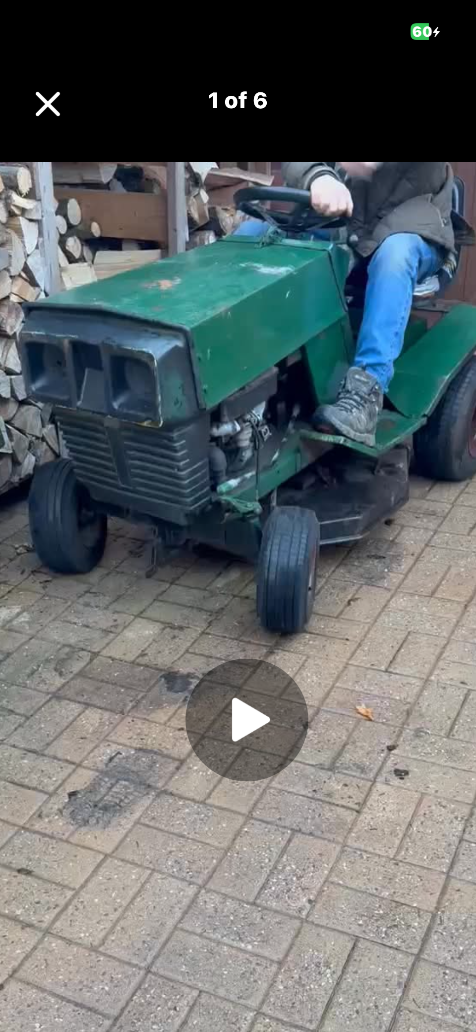

I am new to this world and have recently purchased an old machine which from the little research I have done believe it to be a Westwood possibly a T1100 but will be happily guided on this?
The engine is a Honda GV400
It drives and runs ok but the belt needs adjustment to get the cutting deck working.
I am looking to do a light restoration as I want this in regular use.
And help, advice and pointers greatly appreciated especially sourcing parts once I can confirm the make and model.

The Westwood is usually an easy machine to work on and get replacement bits like belts etc.
I take it that it is a twin-blade mower deck? And 36″?
The mower deck is the earlier version with the angular sides, rather than the later rounded deck. That indicates it might be a later W11 model with the black front nose. This would be late 1970s to 1984ish.
If you think it is a T1100 then that would be the mid-1980s, but that would usually be seen with the rounded deck.
If it was a W11 or T1100, then it would originally have had an 11hp Briggs & Stratton engine with electric start.

ParticipantMany thanks Alan, sounds like it’s had a replacement engine at some point then. I need to have a more detailed look at it but it’s currently stored at my parents.
I will also try to get some more photos next time I am thereFebruary 24, 2026 at 9:14 pm #44610urbanalfa
ParticipantI would agree that it’s a replacement engine. Probably not uncommon that another engine was grafted on to keep the machine working.
