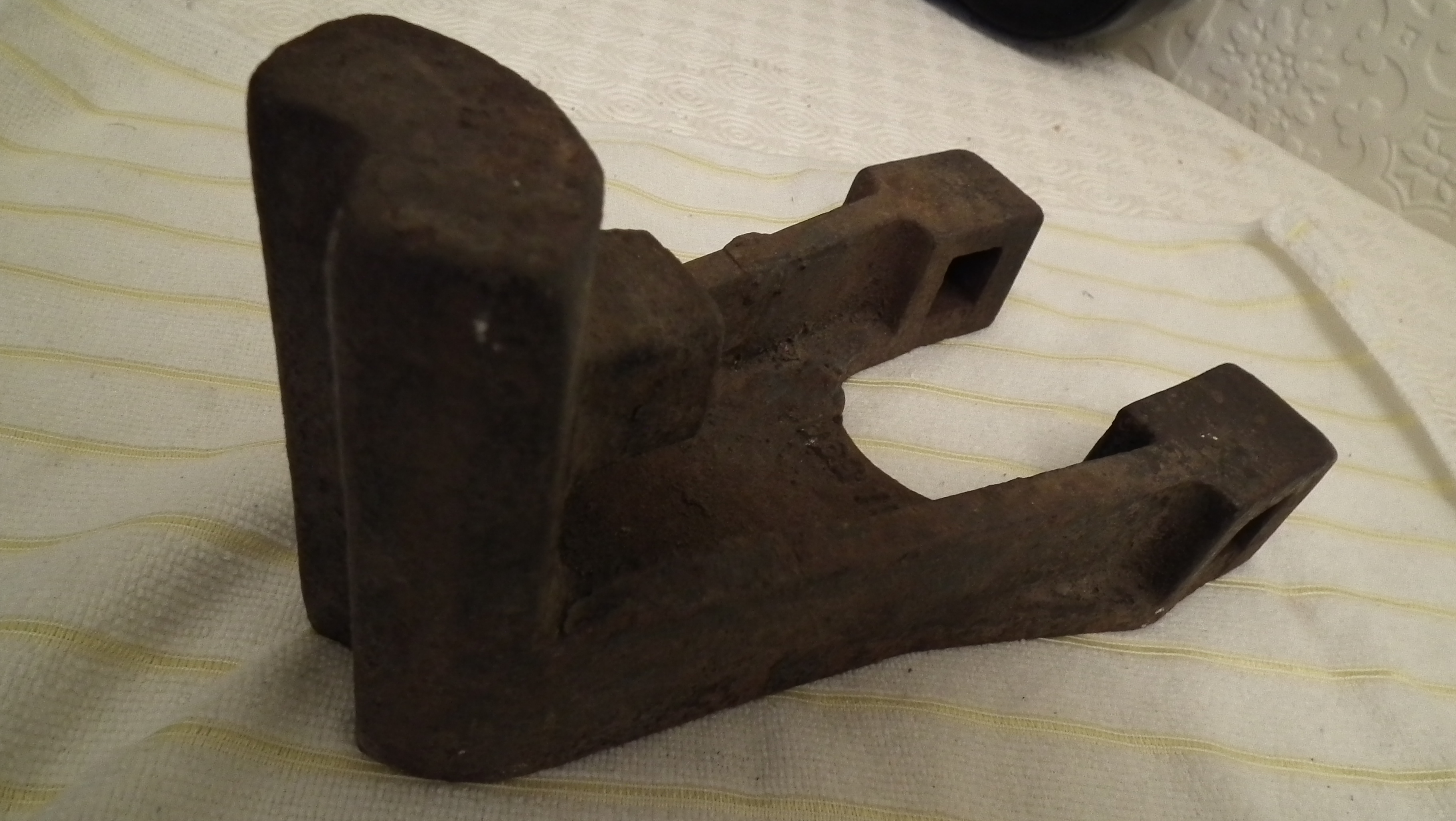

    These are two items I have but am I missing something to attach to a toolbar for a Barford 30?
    #9438
    The l/h one is for mounting on the rear and should have a length of square bar going through the holes, the r/h one mounts on the front and should also have a length of square bar. The rest of the cultivator frame mounts on the square bar. I will see if I can get my cultivator frame out of the shed and take a photo. The manuals do not show the different parts.
