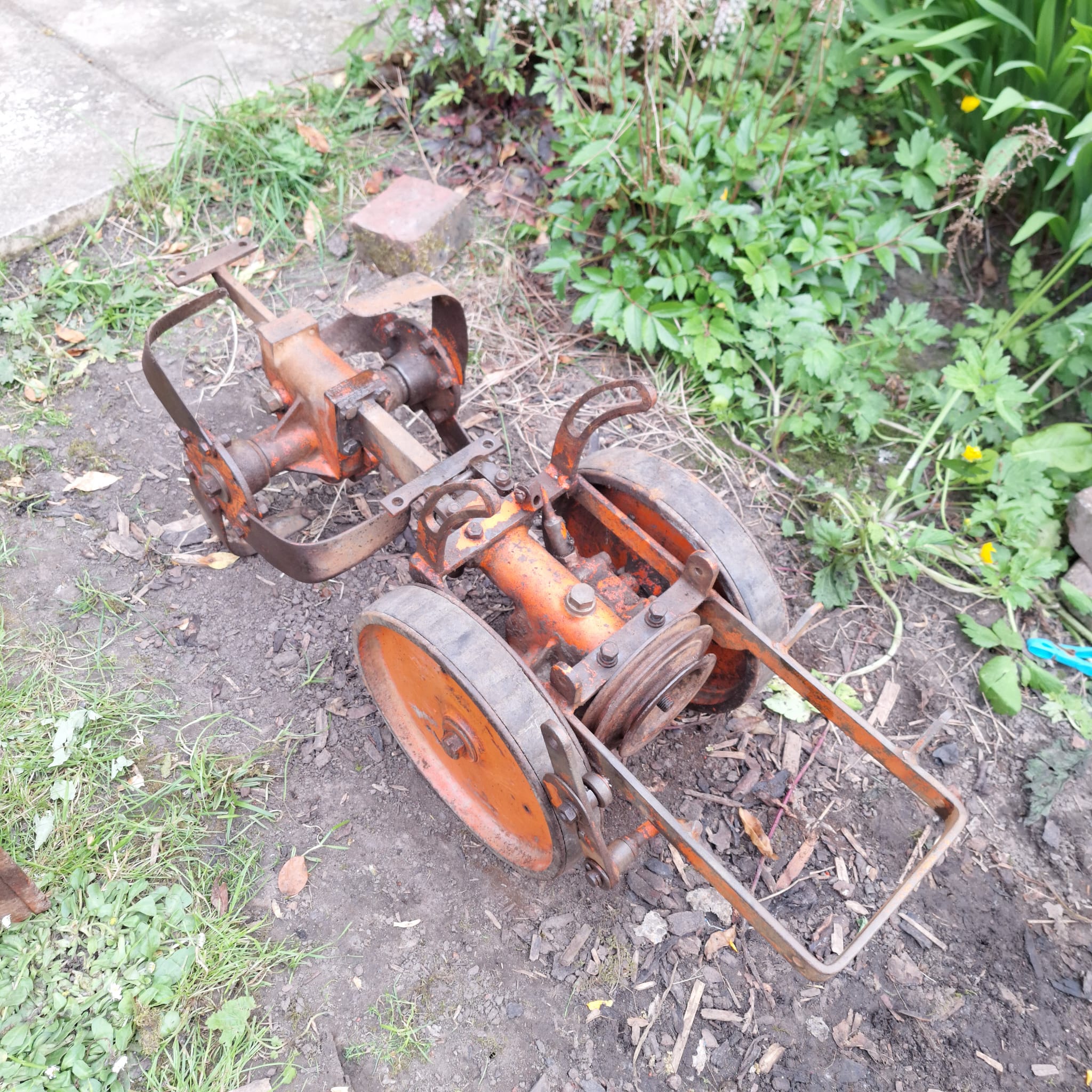

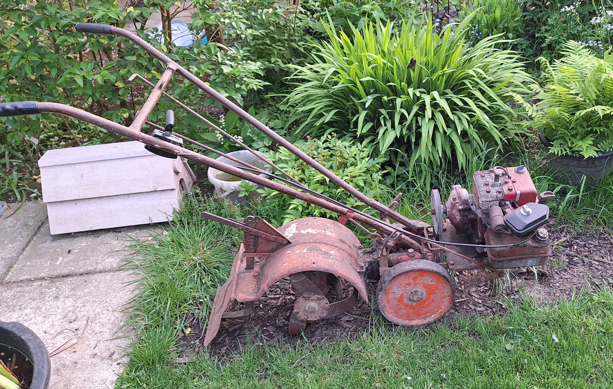

    I’ve been given an old Howard 200 with a Briggs and Stratton 3hp engine.
    I’m working on getting the engine running at the moment. The rotavator itself is a little rusty here and there but overall looks in OK shape.

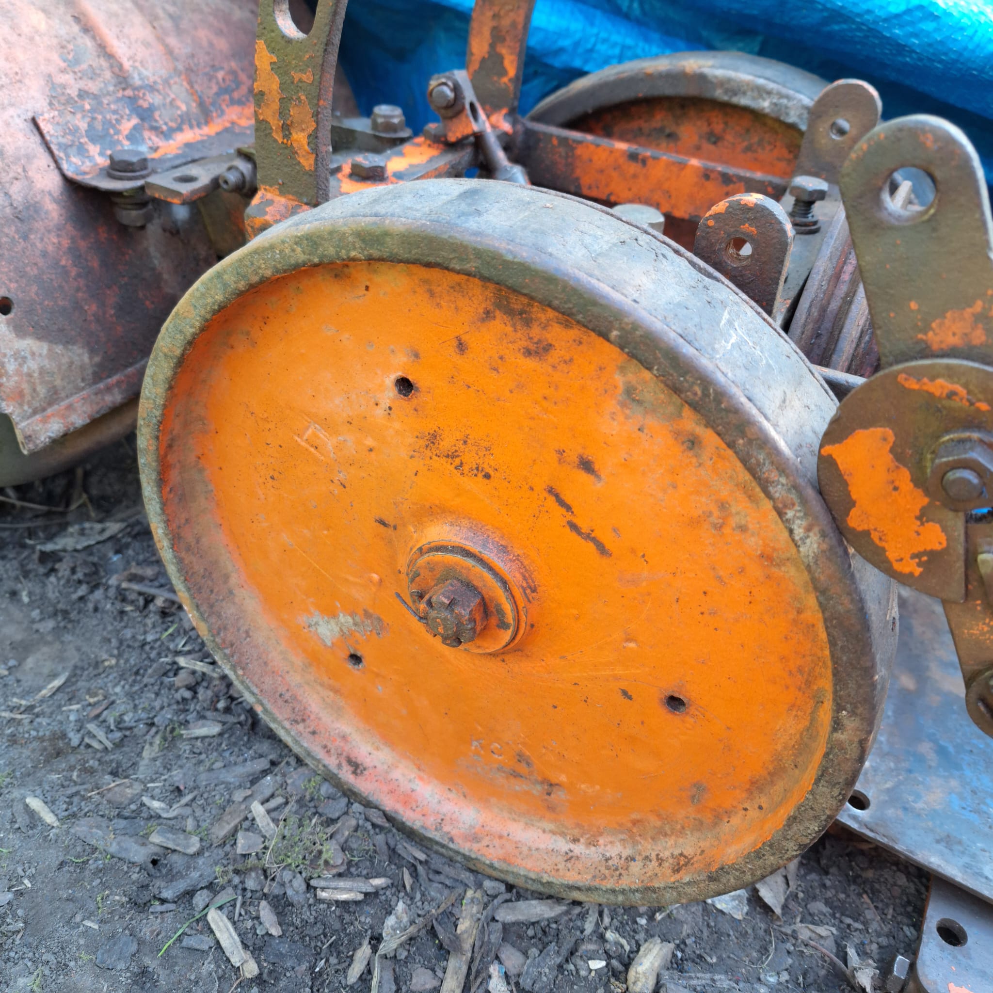

    The tyres seem to be worn completely flat though, I wondered if anyone can advise on where I can find replacements and if there’s a knack to replacing them?
    Thanks.

    I run and use a couple of 200s , they’re great little machines , albeit mine are the later version with the heavy duty chunkier tyres , yours is the early version , and tyres were a problem. My only suggestion is , as others have done is to glue heavy duty cambelt material to your existing wheels , original new ones are not available.
    One thing I must point out , your engine is not really a suitable replacement for the original in that it has a reduction box fitted , and hence the gearing will be totally wrong.

    Thanks for the reply @andyfrost, would you know if it’s possible to swap the wheels out for later wheels?
    If not, I think I’ll have to take a look at the cambelt approach. Thanks.
    Thanks for the feedback on the engine. I’ve been focusing on getting the engine running, purely because that’s the main thing preventing the whole thing from running and something I can get stuck into, but I’m not familiar with these things and I’ve got no idea what to expect once it’s sorted.
    #43742
    The later type wheels will not fit , hence I suggested the cambelt approach, Those little Briggs engines are very reliable and easy to work on , first thing is sort the spark out , and move on to the carb , give it a thorough clean ,along with the tank, and most importantly fit a new GENUINE diaphragm. Any problems , then report back.

    Concur with Andy, get a good spark first, then clean the carb thoroughly and fit a new diaphragm. Have fitted pattern ones and have had no problem with them. If the ignition is a points type, its not the best design. I get to them by using an air chisel with a point fitted and put it on the crankshaft end. A put a prybar behind the flywheel, give the chisel a buzz whilst GENTLY putting pressure on the flywheel. If the combined points condenser, or the coil is duff. I would personally replace it with a transistorized module. Its a dead easy swap and the spark is much stronger. These small engines have a similar rev range and power delivery, so do not think swapping the original for another type will make too much difference to the machine’s operation. A good idea to fit a toothed belt to replace the original tyres.

    The reduction box I mentioned on your engine “MAY” be OK , I see from the pics that it has a fairly large pulley on it , so depending on what the box ratio is it could well work…….the only way is to get it up and running and try.

    I am very sorry but there are no replacement tyres for a Howard 200 / Demon and have not been for around 50 +years This is what We were told by Dowdeswell’s as the last ones were fitted with much better tyres We had a Howard Demon some years ago and We did replace the wheels with the modern type but it was a very big job to do
