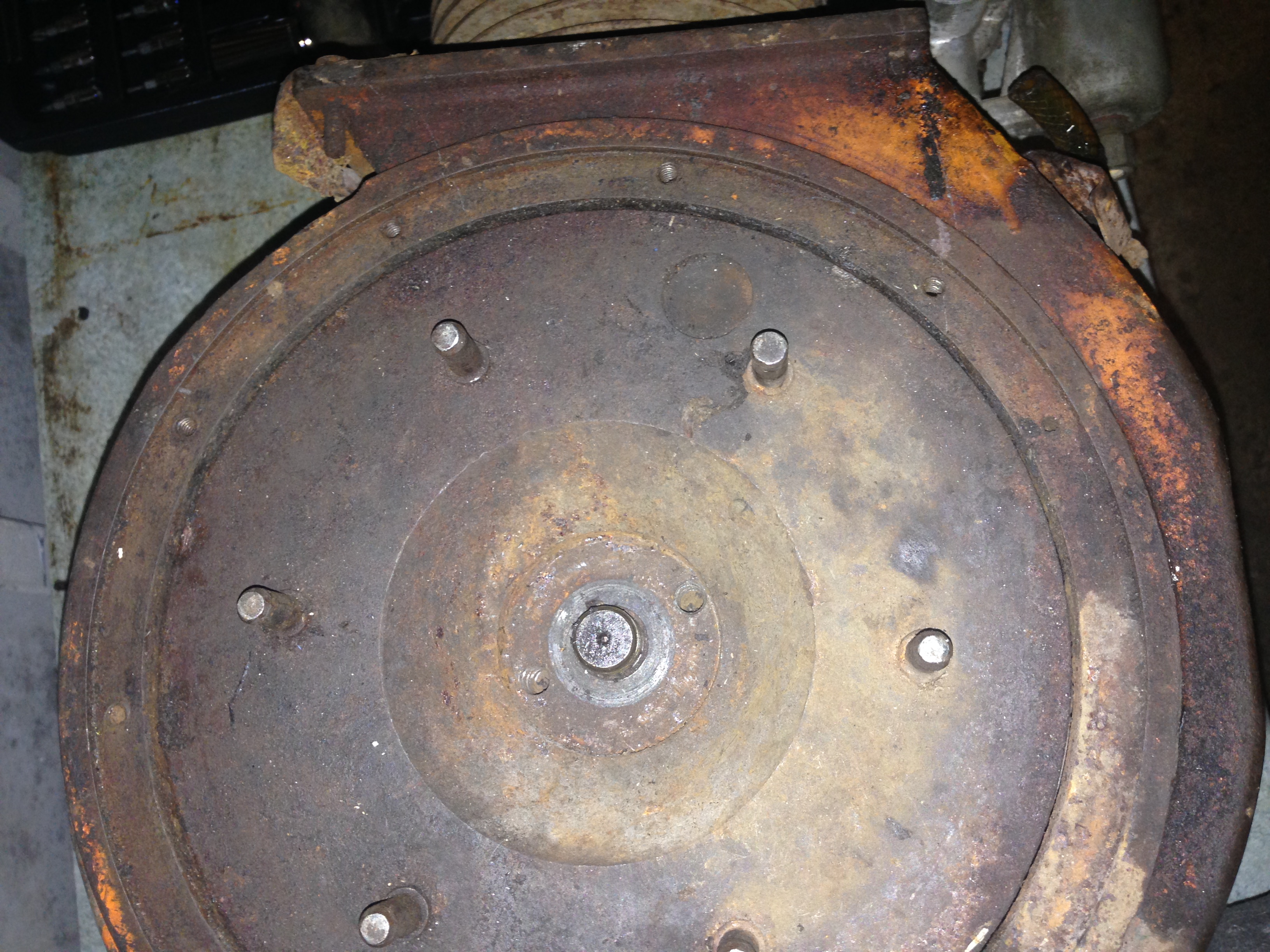

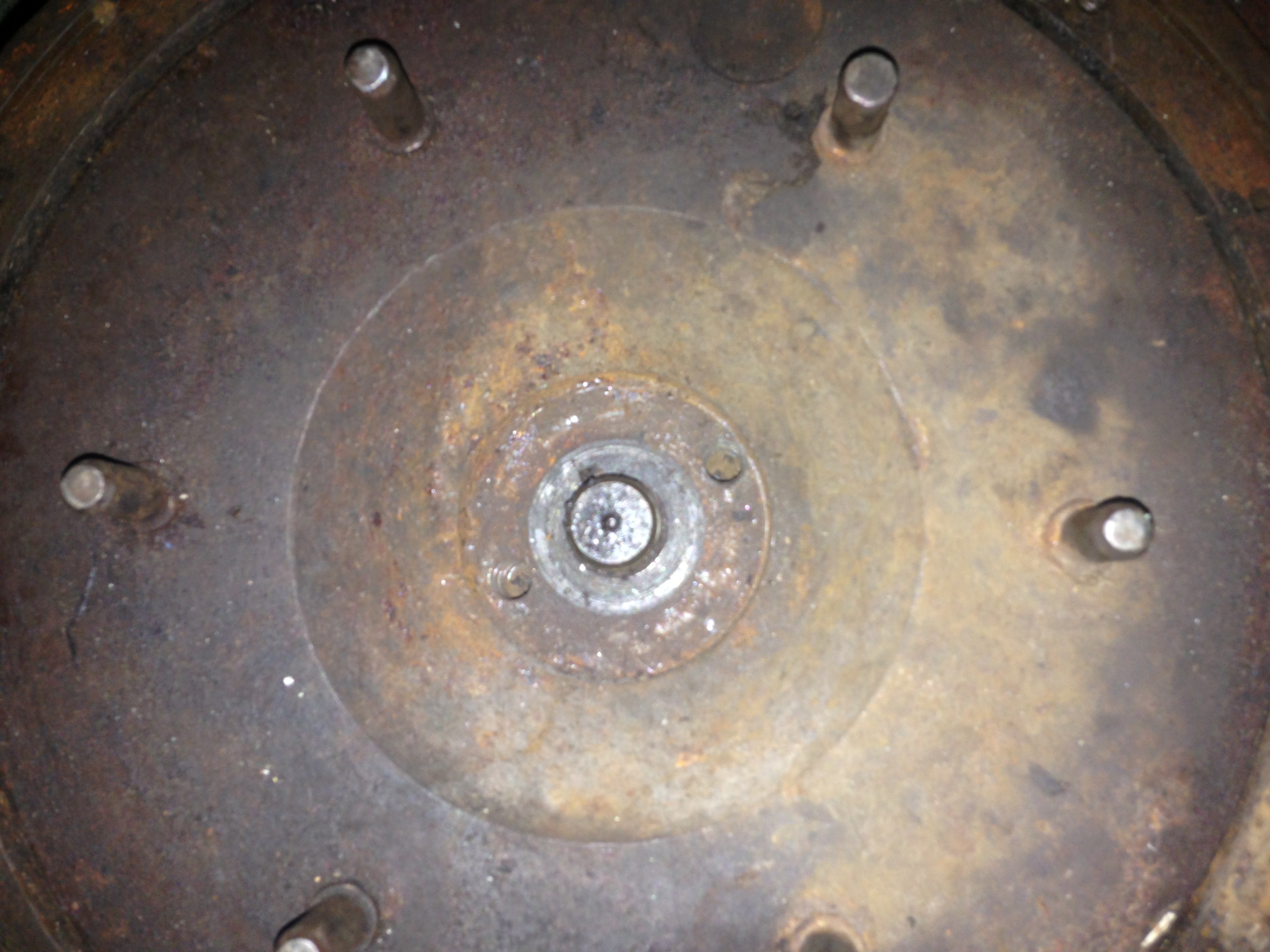

July 28, 2017 at 12:10 pm #26071
vhgmcbuddyKeymasterJuly 28, 2017 at 5:44 pm #26079
vhgmcbuddyKeymasterNow you’ve removed the nut, I find the easiest way to remove the flywheel is to undo the 6 nuts holding the Orange airshroud in place on the opposite side of the engine and then give the shroud a couple of clonks with a soft hammer. Maybe not the correct way but very effective.
