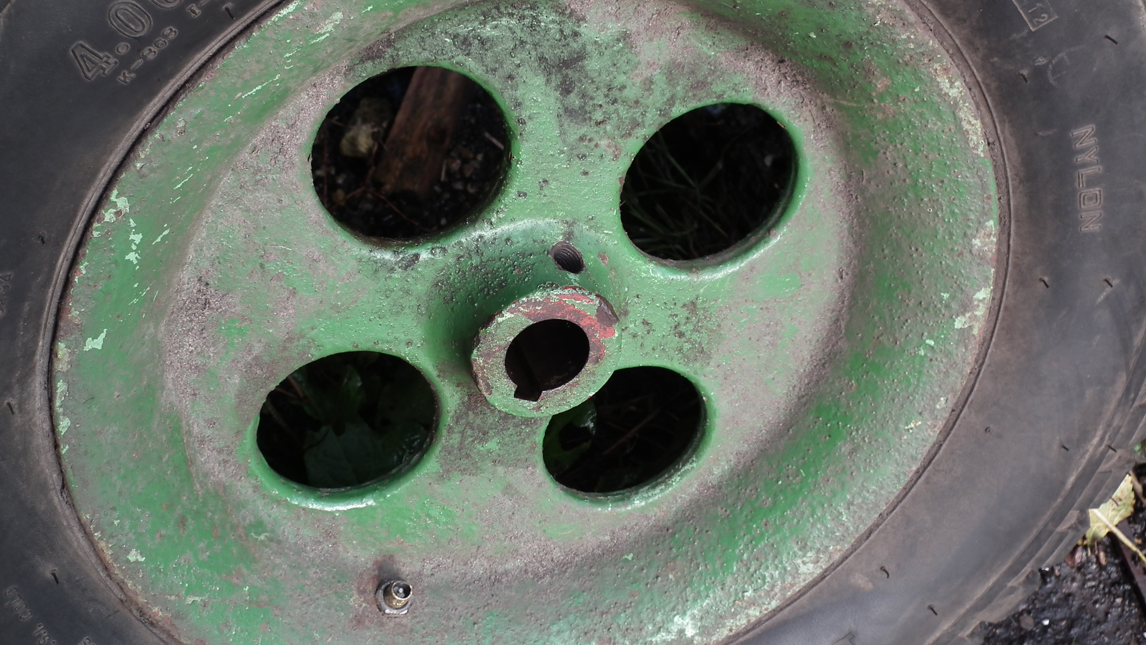

    Hi, Anyone know what is supposed to hold this wheel on this wheel on. The hole in the wheel is threaded(approx 10mm) and is directly opposite the key in the shaft. the cleaned up bore and shaft makes for an easy push on or pull off with nothing to hold it on. I do not have a manual or parts list See pictures

    These are the pictures
    #2531
    looks like there’s a hole for a grub screw?
    #2537
    The thread will not be metric but most probably BSF
