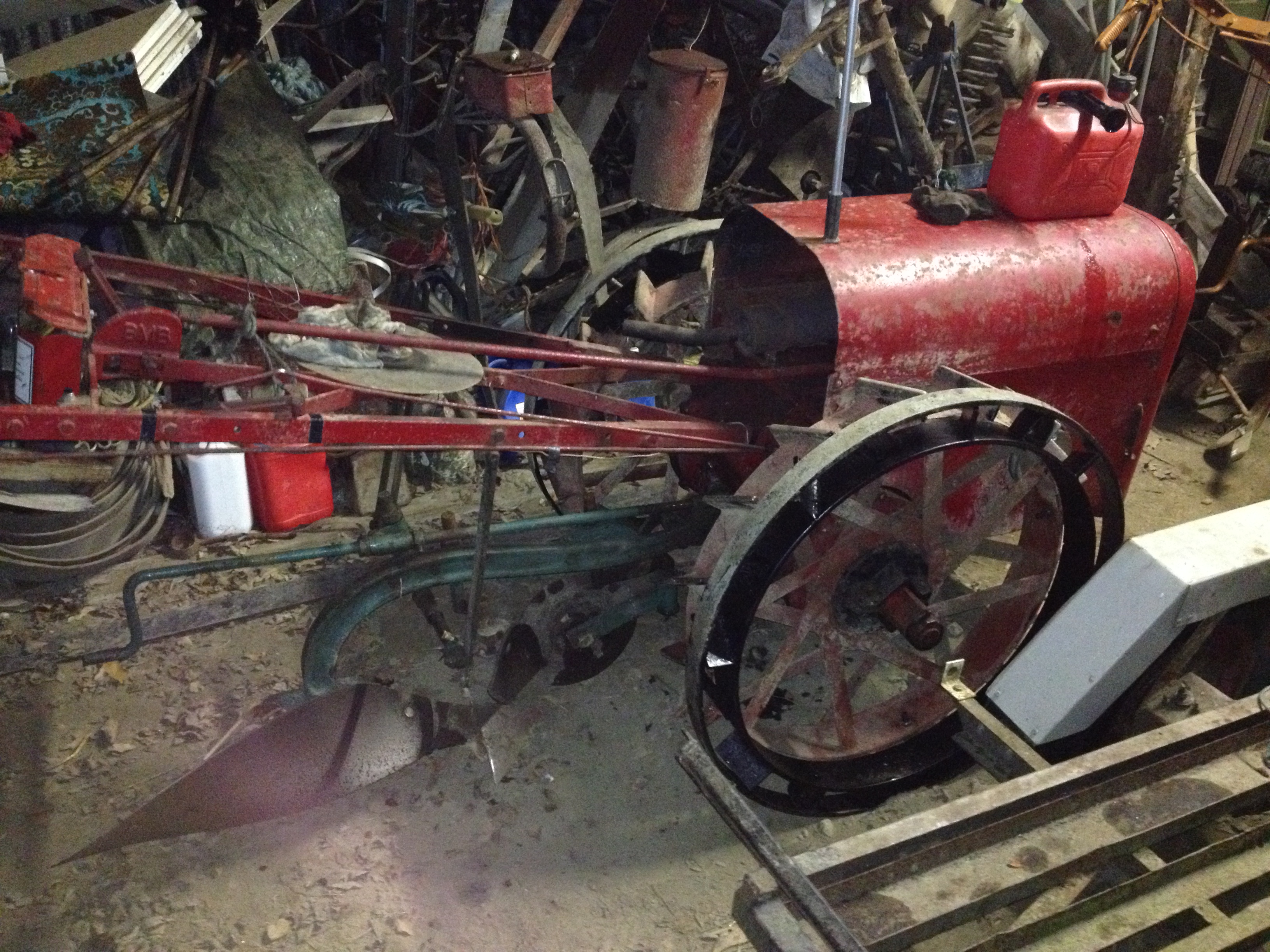

    Hello there, can anyone help please, have a bmb ploughmate tractor with a jap5 engine.
    Trying to get new drive belt and the company need to know the ratio for the strength of belt required.does anyone know this or can they help on this matter.many thanks and looking forward to plouging my ground soon

    All I can add is that I once owned a ploughmate, it had a car timing belt as the drive belt, but not sure which vehiclw it was from.

    This has come up before, a old chap I know had one made by company at Gloucester that advertise a lot. I think he took his old belt and they made new to match

    We got a new endless belt made for our BMB Plowmate. Can dig up the spec that we gave to get the belt manufactured. Endless belt is the way to go.

    Belt is 40 inches long x 2&1/2 inch wide.
    #11806
    Hello, have managed to get a timing belt and it seems to work fine.not sure whether to put two on or kyst leage it as it is.thx for the replies
