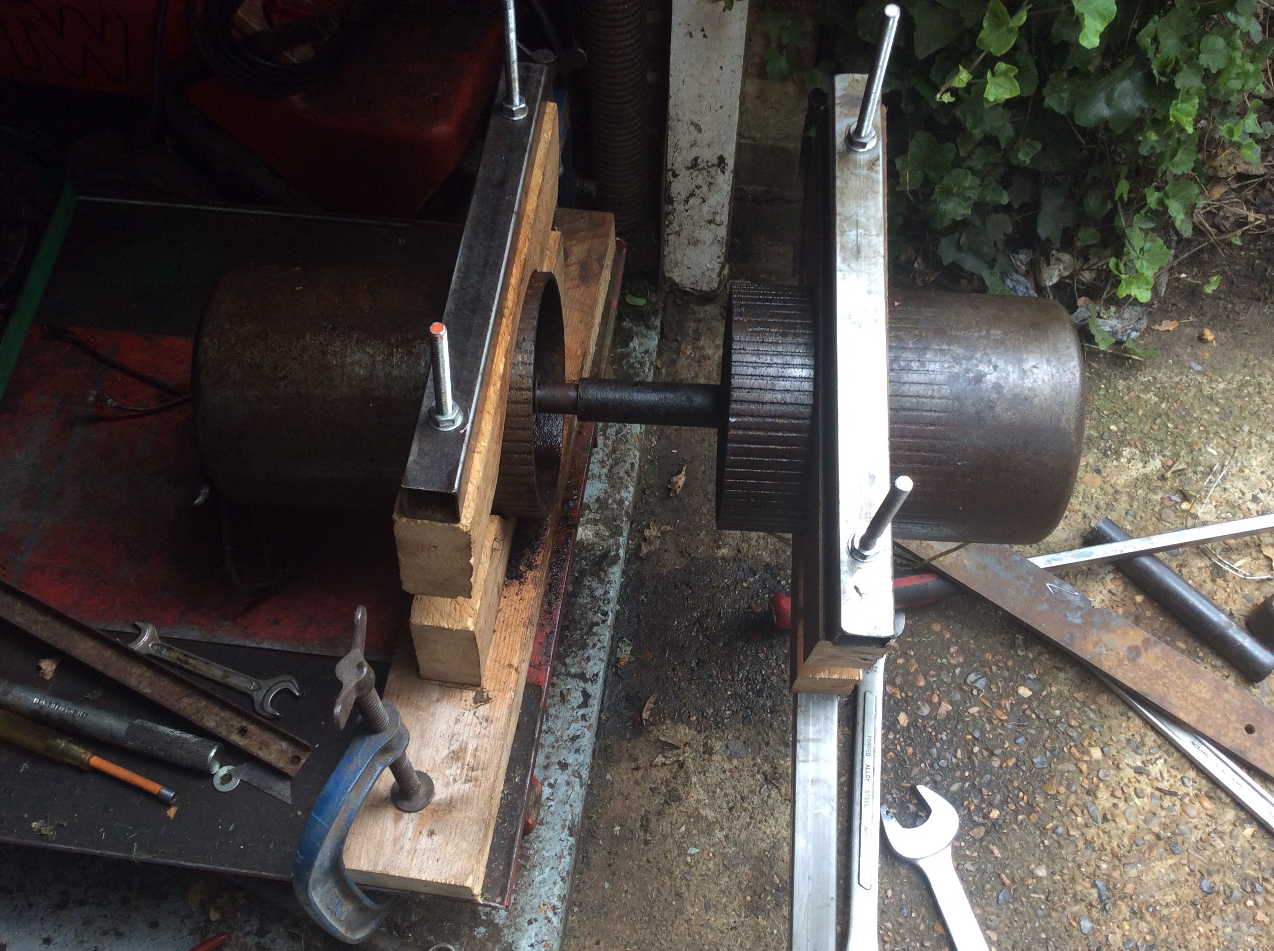

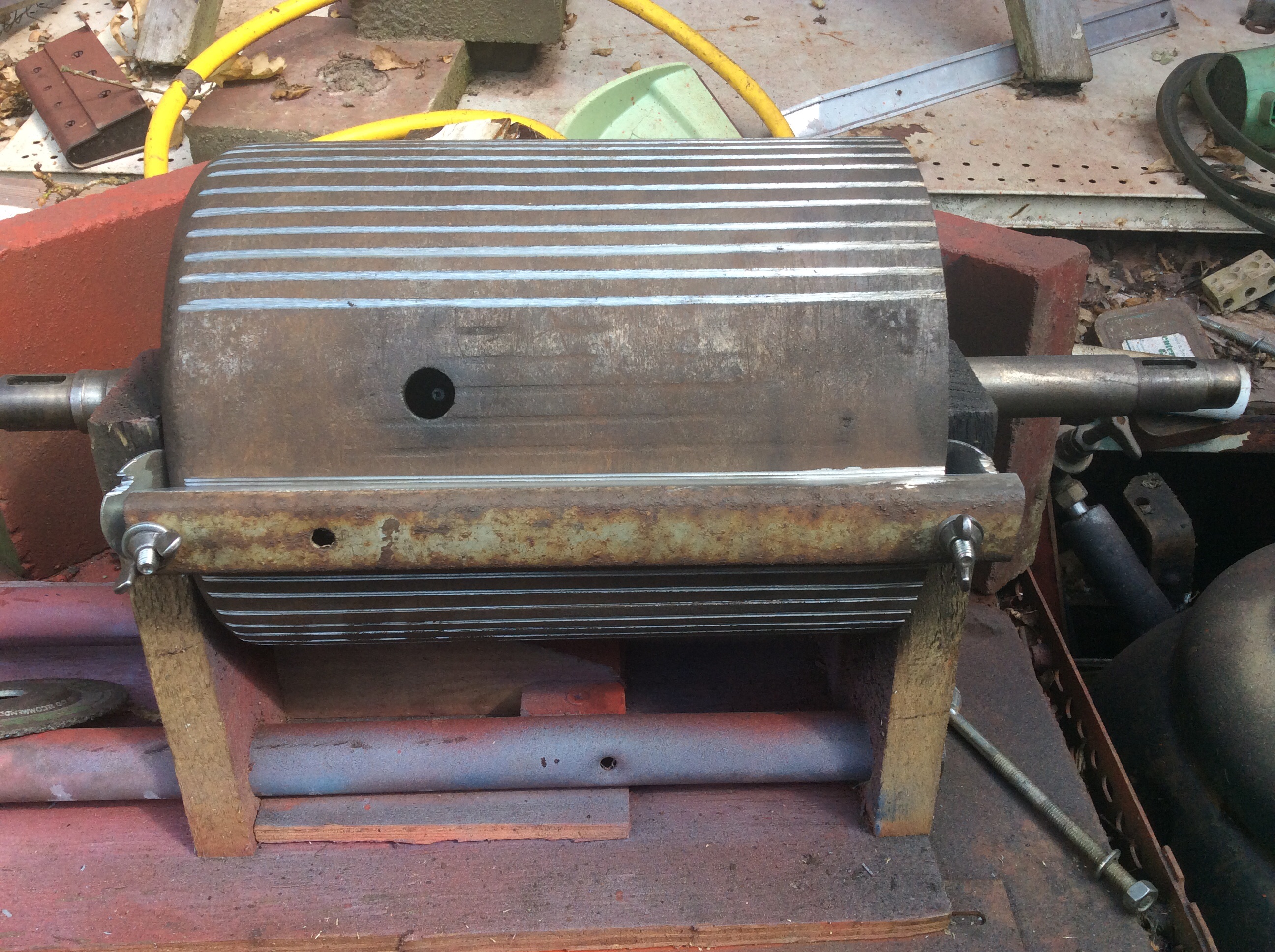

    One point to check is that the two rear roller sections move individually on their shaft and are not seized and only moving as one. If they are seized the machine won’t want to turn and will scuff the turf. Freeing off a seized roller without damaging it (£250 + vat a sectional) can be a right pain – I’ve just done one as the attached images show. Also recutting the grooves on worn smooth roller section!
